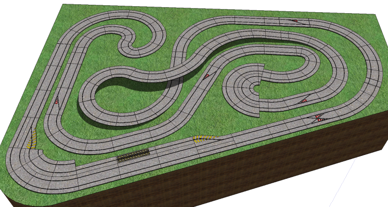

this is my current N'Digital 4-lane track that I would like to change to a Scorpius setup.
Don't know how the N-Digital system works when you need to switch lanes, but can you really go from lane 2 > 3 > 4 and into the pitlane on that short distance (under the bridge)? Shouldn't there be longer between the LCs?
#25 · (Edited by Moderator)
The general rule is one LB per LC + 1 LB for lapcounting.
As the pits count as one LC you dont need an additional LB. However we still need to write the software that tells PC Lapcounter off a pit lane or pitbay entry. PC Lapcounter does not have use for a pit lane exit signal (yet), nor individual pit bay. And then there would have to be a box to tick if you have multiple pit bays on top of the pit lane, which is a slightly different scenario.
It will be all programmable from the LB set up page, so you can assign any LB to any ID and any function, but lapcounting will always be 0.
With lap counting through pits LB comes with 4 LEDs on fly leads, so thats enough for 2 lanes + one for pit lane + one for pit bay. Additional LEDs can be wired (with correct polarity) in series of any of the 4 existing LED flyleads.
Rick.

This is my digital road course. It's currently D132, and is laid out on top of my 4-lane routed track (so I at least get to enjoy the scenery). I plan on re-routing eventually for a 3-lane digital/analog (with some resloting lanes here and there). In plastic, it's about 90', 20' x 12'. With digital I'm racing counter-clockwise.
The top left curve and bottom right curve are about 10" above level. Infield curves are "level", etc.
Bluff Creek Race Park:
Currently the pits are actually on the top straight, and the bottom straight. I needed to have them on opposite sides for D132 as cars would too often slow before making it to the pits and block racing traffic. I plan to route a set of 4-6 pits around the inside of the bottom left curves.
I figure I'll need 8 LB's: 1 pitlane LB ,1 for 2 pit bays, 5 for 5 LC's, and a S/F
