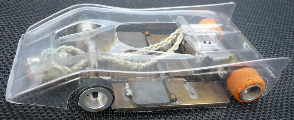

I am getting on with returning my mid seventies club racers from Yorkshire, remember those anglewinders?...to their former glory.
I have obtained from the wunnerful' mr Howmet TX (thanks John) his super repop shells including a FAB McClaren M20, which Ihave already trimmed, and it looks great on the MG 550 chassis.
My questions are: were club racers using brush paint finish inside the shells and what standard of finishing were they using ie. was the aim to produce a real scale model with decals etc or was there a more practical approach taken for racing with colours and race numbers to the builders choice?...i expect it depended on who did the job..from rough and ready to concours?
I would welcome insight from those who were involved "in the day"...ta for now Ken
rough trim ready for sanding edges!

hi ken
virtually all slot racers in the70s painted their shells inside
a quick rub down with a bit of wet and dry and then brush some cellulose dope or acrylic onto the shell
how much detail you put on the shell is up to you ,but there wern;t too many concours shells around
in the 70s
cheers tony

It really did vary but mostly people used one or two brush-painted colours in fantasy liveries. Humbrol enamel used to just about work, if used thin enough, or the new-fangled acrylic paints. Lexan spray and brush paint arrived and stuck much better, but probably not until the 80s. People did use cellulose car paint, but that has to be used with extreme care as over-use could lead to the body curling up, and it attacked any non-cellulose paint it came across. Decals were a bit hit and miss, and many people used to hand-paint their numbers and leave it at that.
Even in the 1970s 1/24 racers dabbled with airbrushed bodies but I don't know what paint they used.
I do remember Ian Fisher having a nice M20 in the correct-ish orange with dark blue wings front and rear - easy to see the stickers on colours like that, and that was always a consideration. John Goldsmith used to do great concours bodies - I remember his BASF BMW M1 (check out the real thing, red and white swirls) and another M1 with a map of France on it. Both were prototypical and I think brush painted, on the inside of course.
I think Tony's M20 would have been two shades of green, but then all his cars were!

PS, Things will get even clearer when you peel the protective skin off the shell.... It's there so you don't need to worry about getting any fingerprints, overspray or paint drips on the outside, but when the paint's done, pick away at a little corner and it will all peel away laving you with a bright 'n shiny shell. (Just in case you were thinking it looks a bit cloudy...)
179 Posts
thanks for the tips john...i had not realised there was a coating DOH!....it must be doing its job well....any tips on mounting bodies on mid seventies chassis? tape? as there are no pin tubes...ken

QUOTE (dragracer @ 10 May 2012, 07:53) <{POST_SNAPBACK}>....any tips on mounting bodies on mid seventies chassis? tape? as there are no pin tubes...ken
That chassis with no pin tubes would almost certainly have used tape for body mounting.
Pin tubes were widely used in that period, so it would be perfectly reasonable to add pin tubes.
