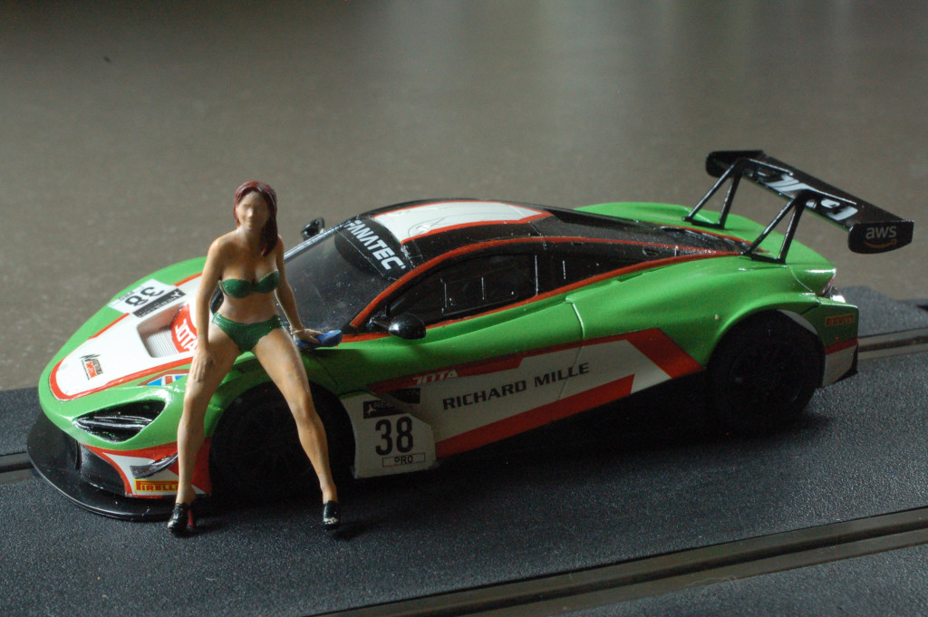

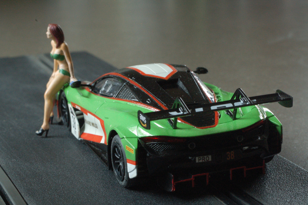

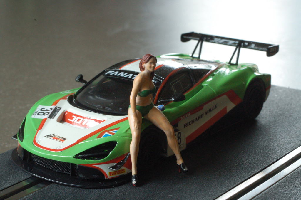

As I am not taking part in this year's painting competition, I can already present you my interpretation of the McLaren Jota car.
The car is being prepared for race by a cute lady.
I hope you enjoy as much as I enjoyed painting it.
Dany

About the green, I first tried the candy bottle green from Alclad with a silver base coat. But the masking tape completely ruined the job. So I reverted to a more "opaque" color from ZeroPaints and since I was also painting an NSR Porsche 997 in Lizard Green ...
For the lady, she is part of the car wash girls set from MAiM (Modern Armies in Miniature ref:MAiM32011)
I've just finished assembling the car today. So I'll try the car on my home track for the steup and take her to the club next Thursday.
But I don't expect to beat those mighty NSR GT3.

I sprayed a ZeroPaints grey primer, then some white and masked the white area to spray the Alclad silver base coat, then the Green Candy all was still ok.
When I removed the masking tape over the white, small areas peeled off. So I masked the green to respray the white again. That was a mistake, the Alclad silver base did not adhere on the ZeroPaints primer and most of the green+silver came off with the Tamiya masking tape.
· ParrotGod
12,942 Posts
I think alclad is the issue here. I had the same issue with their black base: it does not adhere well and peels off.
As for the setup on your carrera track, you are absolutely right. Just put on the sideways the same motor they run the nsr - assuming it is the long can king motor.
However, do not use one that has been used on an NSR car: when mounted on an NSR pod the motor has to run in the opposite direction than on a slot.it/sideways pod.
So get a new NSR king motor, run it in for 30 min at 1,5v in the right direction for the sideways and you should have good performance.
My preference is to ditch the sideways pod and use a 0.1 offset AW pod.
Ah, and use the same rubber as they use on the NSR.

@ Dany, when using paints from different manufacturers I always apply a thin sealing/isolating layer of Mr Hobby Clear (the petrol resistant type) between them.
I think the main problem is the adhesion of the base layer. But I agree that a good clear should prevent any interaction between paint type.
