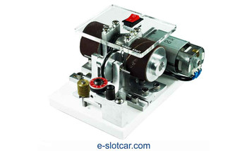

Backtrack - $500
- two wheels at a time, counter-rotating sanding drum
Backtrack Dual Tire Truer

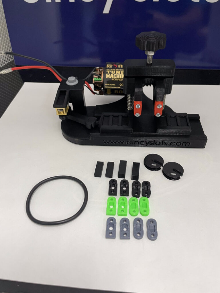

CincySlots Tire Truer for 1/32 and 1/24 Scale Slot Cars -$150
- Sliding plate, built-in reciprocator, special brackets for Carrera 1/24 axles
CincySlots Tire Truer for 1/32 and 1/24 Scale Slot Cars.
CincySlots Tire Truer for 1/32 and 1/24 Scale Slot Cars. Please watch the video for more infomation. https://youtu.be/QxRq-xA0hfg

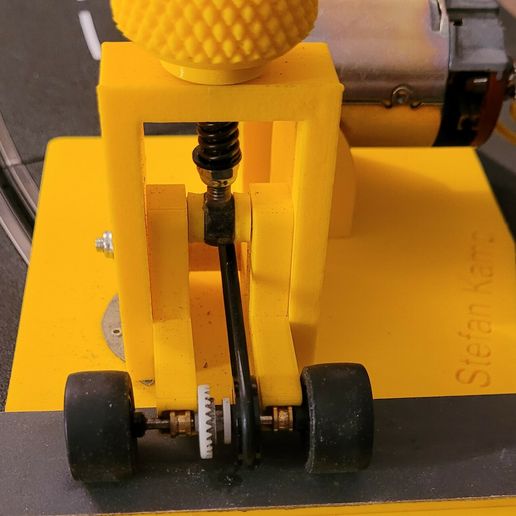

KOMPLETTACHSENSCHLEIFMASCHINE SLOTCAR CARRERA DIGITAL 132 /124
- Sliding Plate.
/https://fbi.cults3d.com/uploaders/23675186/illustration-file/7181d3cc-98b4-4a06-8c45-1f4d69939335/Schleife.jpg)
Complete axle grinding machine Slotcar Carrera digital 132 /124
I have designed a grinding machine to be able to grind the original Carrera axles (132 and 124) of my slot cars as a whole. The market offers only a few alternatives, and when it does, they cost a lot of money. I recommend printing the grinding machine from PETG or ABS, as PLA will probably not...
