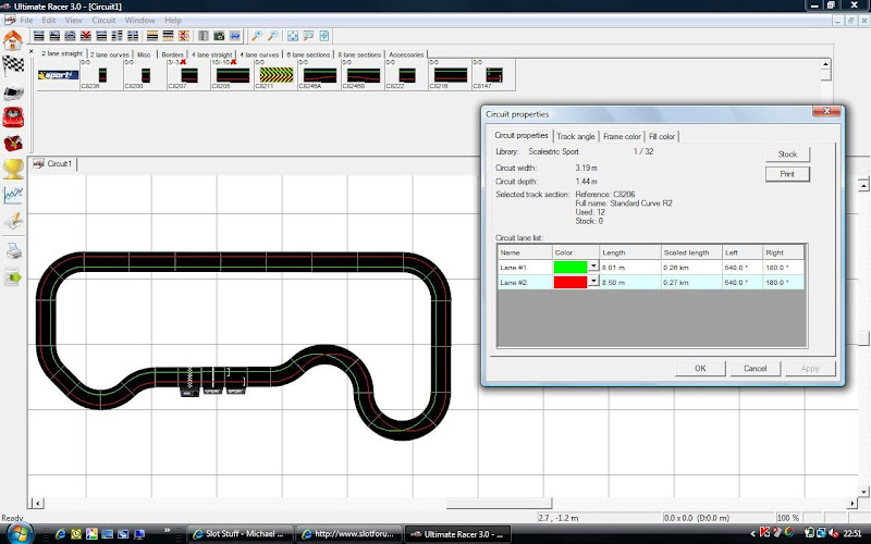

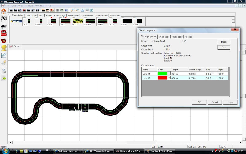

Another one from me
Or just flipped it round as it would look to drive better this way round from left to right
Both still use the cross overs to stay on the inside lane
As how would it compare on ninco track or others as it is a different size ?
Michael

QUOTE (Koala2 @ 2 May 2010, 09:33) <{POST_SNAPBACK}>Therefore an idea to run maximum inside lane without 90° crossing (I have one but, as stated not everyone has it).
Not finalised, only to show that with the (sport crossing R2 90°) you can also run more inside line on one of the lanes.
