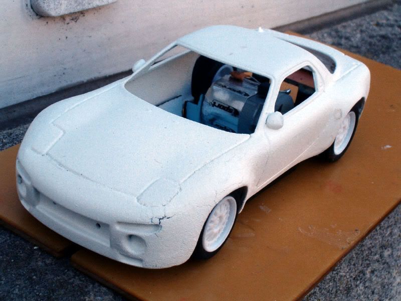

Well after seeing Swiss' impressive Arii Nissan Skyline conversion and the talk of the unusual Arii kits - I finally got hold of one (all be it about 6 months ago!) and with all the talk of Mclaren's Small Car Proxy event, plus the Subaru 360's pics posted elsewhere on this forum - I thought it was time I put down my airbrush, and picked up my hot glue gun.
Anyway here are some progress shots:
The car has a slot-it HRS mount mount (complete with motor - nicked from an Slot.it Audi!), glued into the Arii kit chassis. It is the inline version, because their just isn't enough room for a sidewinder set-up.
With various pieces of the original chassis cut away, the motor, axle and crown fit quite nicely, complete with some borrowed Scalextric VW Beetle wheels (don't know about these - but they are good for size).
So, I still have to fit the guide blade and probably will get on to this over the weekend - also I plan to use a lexan interior (from a Topslot Supra), but with dash and rear section from the original Arii kit.
If this all goes according to plan the Arii Skyline is possibly next, but if the Arii Mazda R360 Coupe from ebay turns up - that could be next hopefully just in time for the Small Car Proxy event.
Also not sure what paint scheme to go for - any suggestions / pics would be great.

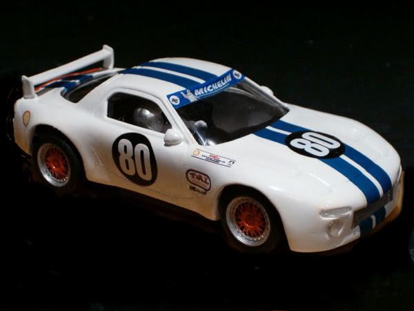

These are the photo's, as promised, of the Rx7, as you can see there is a lot of work remaining to be completed!.
The arches are formed from flat Plasticard roughly shaped to the arch shape and then built up in layers. I then use a filler to form the final shape.

Nice work Alan, was it difficult to mould the arches? Did think about this last night but didn't want to mess it up.

I had a little spare time today so I finished mine off.
Hope to see some pictures of yours finished soon.
Alan
