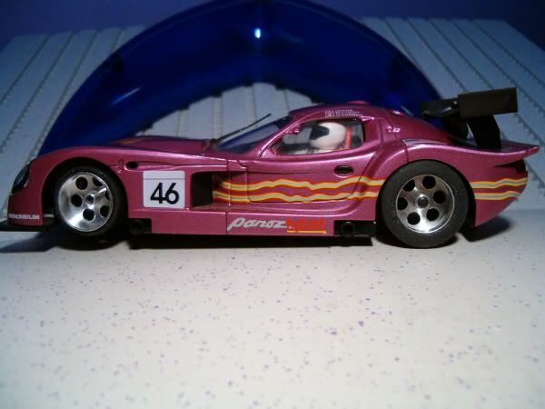

You can make any of the wheels fit any of the axle combinations if you are prepared to sleeve the axle or drill out the wheels, but as Mclaren says it is much easier to either use 3mm or 3/32nd.
NSR tyres are good on Sport track and are available in the UK from Andy Brown- Searle at AB Slotsport.
This is a set fitted to a Fly Panoz Esperante with standard fly gears/axles, (including front stub axles). The wheels require drilling out to fit.
Alan
PS Hope you are talking about Non-magnet cars, cause I haven't done any testing at all on magnet equiped ones.

are those the nsr rims on that panoz? it looks quick
