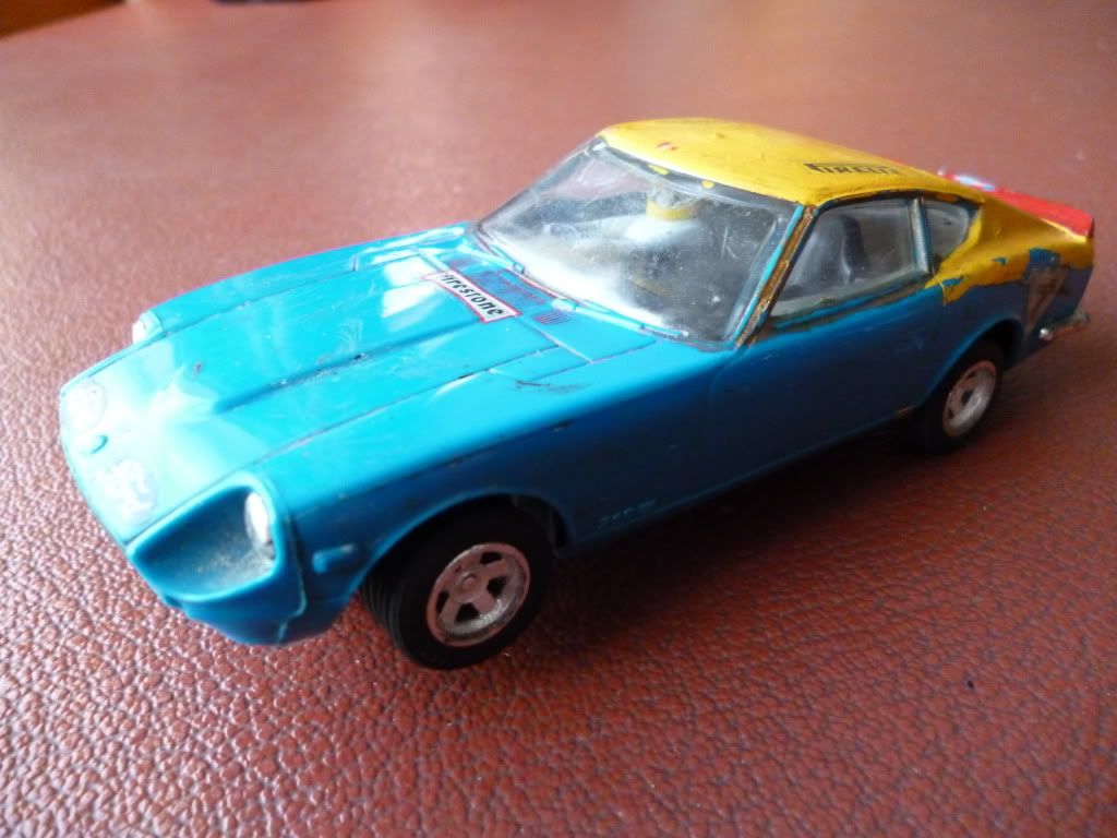

i need to strip this back top a clean , bare , shell.
and after spending about 10 hours stripping a fully enamelled mk1 escort with cellulose thinners, a stanley blade and my heart in my mouth , i fancied doing this one the easy way! acetone free nail polish remover seems to keep coming up as the weapon of choice but after perusing ladies supplies in tescos whilst trying not to look like a 14 year old buying condoms for the first time , it seems to loosen the enamel ok but i was a little "miffed" to find that it seems to soften the plastic more than celly thinners did. any ideas or tips slotters?

no ideas guys? i have just cleaned rattle can acrylic off a properly knackered scrap mini using aerosol brake cleaner. it didnt seem to affect the plastic too much but still not sure about putting it on this zed shell.
looks like a trip to tescos again!! cheers for the ideas guys...and the offer wraith!
hope i've done the right thing?! it's in it's "brown bath" and looking like a freaky fish specimen from the natural history museum!
QUOTE (Mr Modifier @ 21 May 2012, 21:25) <{POST_SNAPBACK}>Looks like Dettol.
it was dettol. the emphasis is in "was"!! note to self , never buy another car that needs stripping , or listen to old wives tales about what to use to strip them. fortunately my curious nature led me to have a little peaky at the shell before i toddled off to bed last night. glad i did because it had started to pickle. while the enamel paint had started to soften so had the shell , it had also bleached. while i wasnt worried about the discolouration (i'm re-painting anyway) , i didnt fancy a gooey lump of plastic to try and work with. i washed the shell clean and fortunately it doesnt seem to have suffered too much , the surface seems to have hardened and the colour even came back , if a little blotchy in places. i think it'll be back to a very gentle rub with some cellulose thinners and wet wipes on this one , as i did with my last "clean off" job.

i've been off work with a buggered back and even sick of fed up of top gear repeats on dave , i bit the bullet and dug deep into the project box and had another go at stripping the "dreaded zed"!! i set to it with a scalpel and some very fine wet and dry. after finally getting all the old paint off , opening up the shut lines , removing all the nasty bit off the shell (badges , indicator repeaters , roof "nipple" etc etc) and repairing the spoiler i finally ended up with this.
it looked even better after an initial prime. its since had a light flat back & a second prime. time for top coat tomorrow. happy days.....barring the back!!!
