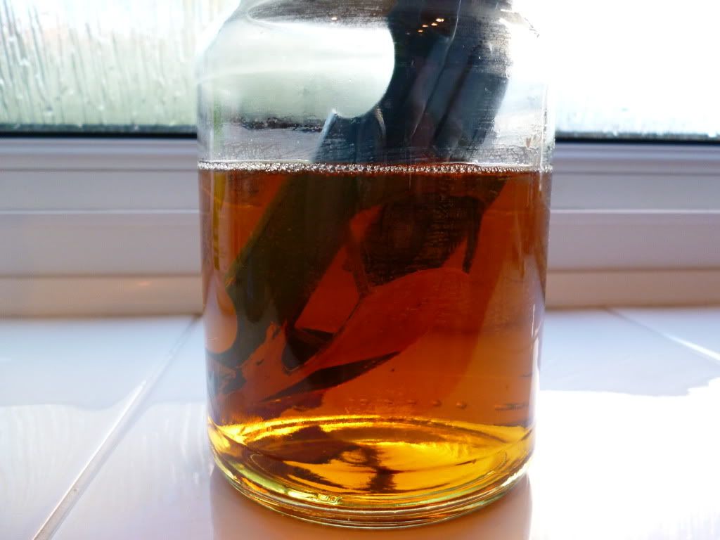

hope i've done the right thing?! it's in it's "brown bath" and looking like a freaky fish specimen from the natural history museum!
What have you put it in, Isoproplyn is clear, it goes foggy with the paint but that settles?
QUOTE (Mr Modifier @ 21 May 2012, 21:25) <{POST_SNAPBACK}>Looks like Dettol.
it was dettol. the emphasis is in "was"!! note to self , never buy another car that needs stripping , or listen to old wives tales about what to use to strip them. fortunately my curious nature led me to have a little peaky at the shell before i toddled off to bed last night. glad i did because it had started to pickle. while the enamel paint had started to soften so had the shell , it had also bleached. while i wasnt worried about the discolouration (i'm re-painting anyway) , i didnt fancy a gooey lump of plastic to try and work with. i washed the shell clean and fortunately it doesnt seem to have suffered too much , the surface seems to have hardened and the colour even came back , if a little blotchy in places. i think it'll be back to a very gentle rub with some cellulose thinners and wet wipes on this one , as i did with my last "clean off" job.
Ha ha...oops, sorry for laughing Pete, but Wraith asked you what have you put it in?, and Mr Modifier said it looked like Dettol??????, you're reply was... it 'was' Dettol?????......sorry but that ain't Dettol mate because there is NO WAY that stuff will pickle plastic even if you left it in there for a couple of months.....
Besides bud, whatever that 'dodgy' stuff is in your jar (it's probably some kinda paint stripper!!!) it looks nothing like the stuff in my jar, which is Dettol, look back and compare.
Sorry Pete...always read the label.

sorry that you seem to have taken umbridge at a throw away comment on my part. i was fully aware that the car i bought would need a degre of stripping and went into any subsequent method of removal ,wether suggested by yourself or anyone else , with my eyes open to the posiblity of some sort of failure! i meerly wished to pass on to others the fact that what method works on one car may not always work on another!! i would hate to be responsible for an individual wrecking a , potentially valuable , shell. i had better take the bottle marked "DETTOL" back to the chemist that i bought it from as clearly i have been scammed into buying some kind of "devil water". if i could be bothered to go out to the shed and take a picture of the bottle as proof of what i bought i would but......i cant!!!
i used dettol, no worries. as do many wargamers, also with no worries. not sure why you had issues, did you get the antiseptic one?
it was the original "old fashioned" type. the stuff that smells like an old school nurse!! i wish i had taken some pictures of the shell but i was in too much of a hurry to clean the residue off and stabilise the plastic.
QUOTE (petestrike @ 19 Jun 2012, 20:36) <{POST_SNAPBACK}>it was the original "old fashioned" type. the stuff that smells like an old school nurse!! i wish i had taken some pictures of the shell but i was in too much of a hurry to clean the residue off and stabilise the plastic.

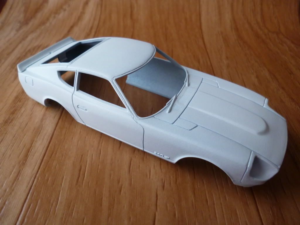

i've been off work with a buggered back and even sick of fed up of top gear repeats on dave , i bit the bullet and dug deep into the project box and had another go at stripping the "dreaded zed"!! i set to it with a scalpel and some very fine wet and dry. after finally getting all the old paint off , opening up the shut lines , removing all the nasty bit off the shell (badges , indicator repeaters , roof "nipple" etc etc) and repairing the spoiler i finally ended up with this.
it looked even better after an initial prime. its since had a light flat back & a second prime. time for top coat tomorrow. happy days.....barring the back!!!
photo bucket is realy being an @rse tonight......!!
Looks v good so far
