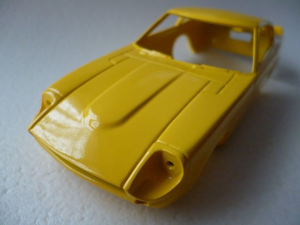

i need to strip this back top a clean , bare , shell.
and after spending about 10 hours stripping a fully enamelled mk1 escort with cellulose thinners, a stanley blade and my heart in my mouth , i fancied doing this one the easy way! acetone free nail polish remover seems to keep coming up as the weapon of choice but after perusing ladies supplies in tescos whilst trying not to look like a 14 year old buying condoms for the first time , it seems to loosen the enamel ok but i was a little "miffed" to find that it seems to soften the plastic more than celly thinners did. any ideas or tips slotters?

cheers.... looking even better now though. this is straight out of the can. having to restrain myself from cutting and polishing it....cant wait to see it reeeealy shine!
from this......
to this. rather pleased too.
That`s a lovely paint job Pete!
Kev
cheers kev. i am pretty chuffed with the end result.

i certainly will.....sometime! i also would like to get some badge decals for the bonnet and c pillars too , if anyone knows where i can get some? i removed the moulded ones along with the wing repeaters and some other details that looked pretty poor "naked" , let alone painted. the wing badges did survive painting though and should detail up ok.
