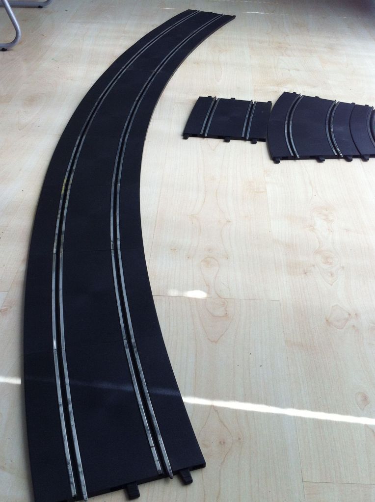

With this track part you can make this kind of long, smooth and wide curves. What you see here is a 45 degrees bend, i used 9 pieces of 5 degrees to make it. This section is around 1.8 m. / 6 ft. long.
Though not produced anymore, they're still easy to find on (italian) auction sites and so. Also, quite some Italian slotrace clubs have 2/4/6 lane polistil tracks, often including this wide curve.

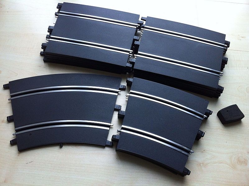

With the use of rail gum, you can polish even old and rusty 2nd hand track pieces back to a shiny and almost new state.
In the earlier pictures i used the old track pieces prior to cleaning/polishing. Here the result after rubbing them with rail gum (a well known product in the railroading community).
