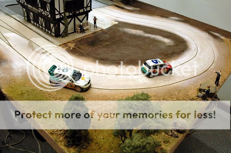

I've been working hard on my track these days, but first a little more updates on the scenery.
I have concentrated the focus now on the cobblestone village. I began modelling the road and pavements. Sorry about the poor quality pictures, I'm still learning how to handle these big cameras.
Here we go.
Then painted a primer gray with airbrush
Finished the cobbles with sandpaper
I'm not very satisfyed with the colour of the pavements, so I'm thinking if it'd be better to paint them with lighter shades of beige or sand colour
...any ideas?
Well while I was stucked at this point I moved to another section to make it refresh my ideas. I have used here many different materials such as tile grouts (for soil), woodland scenics grasses and noch alpine meadow grass. I'm not sure if I should put crash barriers at this turn.
...but the result was very satisfying.
I made these trees with home made fine turf (stained sawdust and floral foams) and polyfiber from woodland scenics.
thanks for looking!

Hi,
Thanks folks!
@Greg
Indeed the track is analogue but the reason of that lane changer is very simple. I have two lane changes in my layout (one LC is simple and the other, seen on this picture, is able to be configured) so the idea is to make the track lengh longer when there's only one driver, in this case the car will travel on both lanes.
@Ember
For me the cobbles look ok, but I like the idea of dry brushing ...but I may try it with a very soft one as I don't want to see any marks of it on my cobbles. The problem is actually on the side walks. I was thinking about painting the pavements borders with a different colour from the cobbles too, but I'm not so sure how to do it. Airbrushing don't seem to be the best idea though.
- On the Das clay, first, I paint pva glue on a small area of the MDF then I stretch the clay on an acrylic base using a hand roller, then I cut a section of the clay and glue on the MDF, just now I model the cobbles with blades. I keep repeating this process untill the road is finished, step by step, cause you need the clay very wet (you need a water spray) while making the cobbles. The good thing about Das is it doesn't shrink after it dries, and won't come off at all if you paint pva glue before laying the sections.
cheers!
