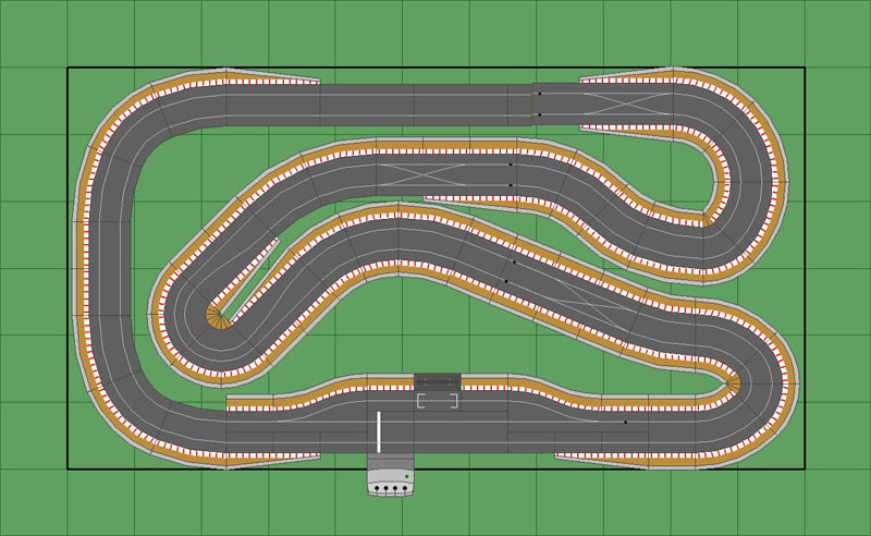

Ok, now that's cleared up, here's the track I did for a table of that size. I have a few others, but I like this one the best. This is a flat track. If you want an overpass, that can help add track to the lap, but it's not always a good thing if the lap is made up of repetitive turns. Note that I did put a right hand pit, and yours is left. It's possible to convert them, but someone else will need to provide tips on how to pull the flipper fixing pin on the exit piece, as I've never converted a pit lane, I've only done CLCs with loose exit flippers. Moving the electronics and solenoids over is easy, though. I did work in your hairpin set and most of your R2 turns. I like magless, so my tendency is to work in border room wherever possible. There's also room behind the pit lane for a garage if you like.

This looks great mate. A nice and fast track alright. Only problem you mentioned is the Pitlane...
I will need to invest in some XLCers, over in NZ they are over $100NZ each. So I think I'll have to search out either ebay or Aussie for some parts. They must be cheaper!

I put in lane changers where they would work. You can get by with just one, but one or two more couldn't hurt. You could also put a CLC up in the top right instead of the XLC if you wanted.
