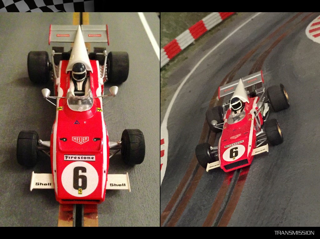

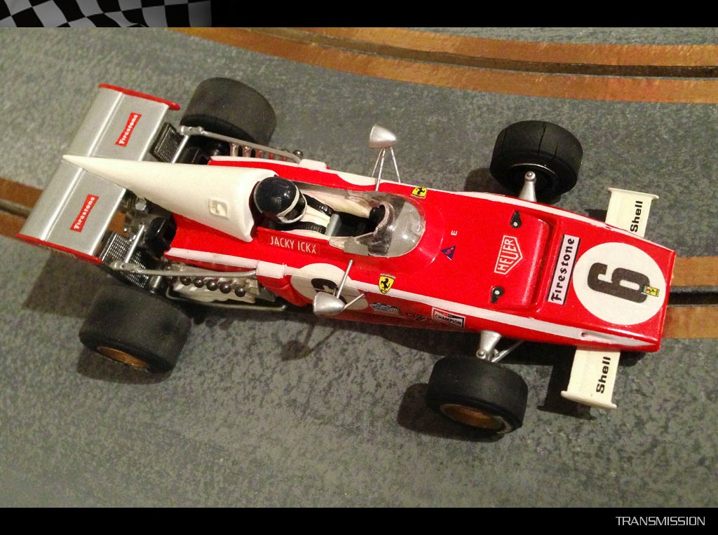

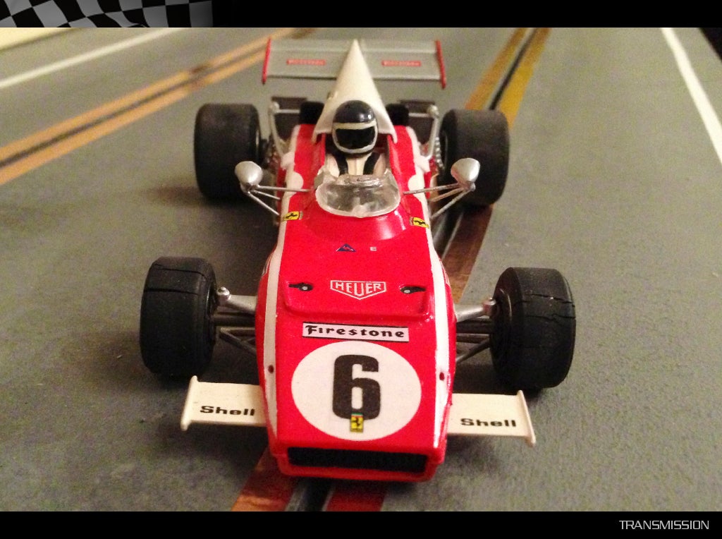

Ferrari 312 B2, 1972
This is a golden oldie I did many years ago but it's still one of my favorite cars as it goes really well and it just looks awesome when going around the track. It is a modified Scalextric that many of you will probably own or know. The most important alteration that really brought the car to live was lowering the nose. The car has a much better stance now. Also the mirrors did a lot for the overall look, even if they are a bit too bulky. Added suspension detail, repositioning the rear wings and a livery based on the Jacky Ickx/Monaco 1972 race have also done wonders to the nice but fairly basic original Scalextric. It is by far not perfect but it is very pretty.
