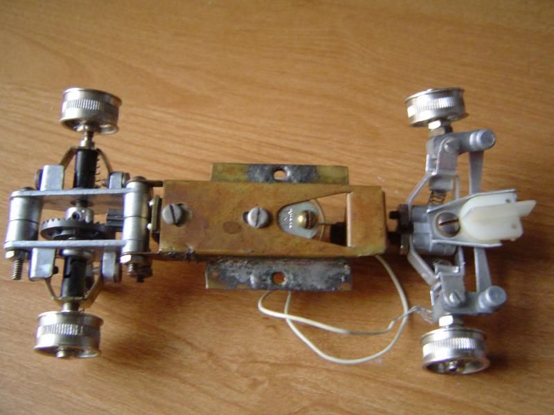

2,785 Posts
Hi Don,
Nice Allard.
I actually have the brass chassis component, seen in photo #1, and again in photo #10.
Didn't know what it was !!.
Perfect condition, came in a lot of other bits and pieces, no use to me, give me a pm if you are interested.
vbr Chris A.

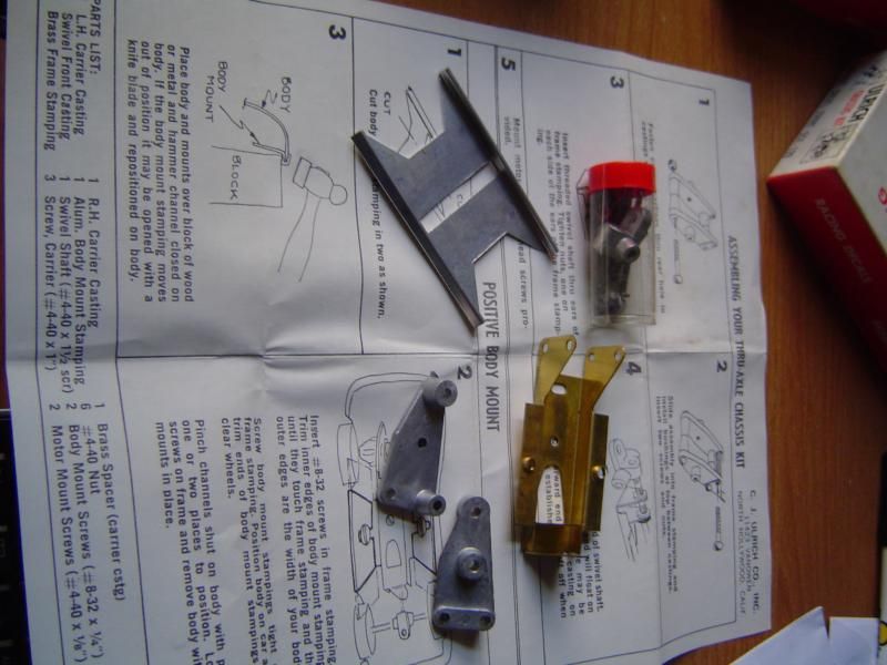

186 Posts
Evenin
I'm having a bad picture day, hope you can see it. I've had this for years
and had forgotten about it. do you see any bit's, pieces that relate to the
chassis?, i have MDC gears and threaded axles for the rear section but
curious about the front axle carrier?. Thanx CG
· Administrator
11,849 Posts
CG,
That's the chassis and rear suspension all right, just looks like somebody flattened out the front part of it! The original one just came with a small casting that was screwed into the two front holes and had its own holes for the guide and front axle. Not really a very elegant solution! The steering front end unfortunately kept the mounting system, being just hung on the same single bolt. Looks like you're just missing a couple pieces of hardware for the rear - I've got an extra axle if you want...

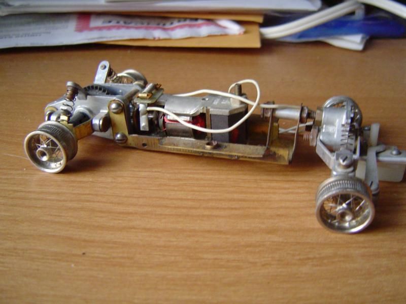

227 Posts
Here is mine I built several years ago. When I got the kits, it was the first time I saw them in person. I had only seen pictures before that. The brass center section I had in my parts box and never knew what it was for until I opened the boxes. I used that one and was planning on replacing it when I got the chassis sorted out.
The track I tried it on was a commercial track in my friends basement. We ran only vintage cars on it. He did not allow any glue or liquid traction aids so we always ran silicone tires. I had them on this chassis, but it would not go w/o the front end coming up so high it deslotted. I tried higher ohm controllers, different gear ratios, and eventually went with NOS rubber tires. If I eased the throttle it would go, but even accelerating out of a curve the front end still came up too high. I eventually gave up and use it as a display item. Maybe some day I will try again. I want to put an open wheel body on it. It would be a shame to cover up the suspension.
Marty
Marysville, OH
1,487 Posts
That looks great Marty ! One of the cleanest Ulrich chassis out there ! Looking at the front end Marty , possibly those front springs may have too much tension for the guide to stay in the slot! Try to either compress the springs a touch, or find some with less tension. From memory, my friend replaced the front springs on his Ulrich car , and it did go well after the spring change. Sure, it will not be original if you change the front springs, but you can put the original springs back after you have your fun. Zig
1,487 Posts
Also Marty , that front aluminium section, which is incorporated with the guide, is bent on the right hand side. if you look at Don's pics , it is meant to be straight. I am no expert with Ulrich chassis, but it could be the problem. Zig
207 Posts
To get one of these chassis to run well without de-slotting , I removed the screw that holds the guide flag assembly to the aluminum chassis front, and replaced it with a longer screw and used a plastic axle spacer between the guide flag assembly and the aluminum chassis front. I use a piece of track to view how deep the guide goes into the slot , and this depends on the front tire diameter and the type of track you are using. I also added some lead weight in the brass center section near the front.

Discussion Starter · #19 ·
Yep, that's one of the main tricks on the Ulrich chassis - it needs some kind of shim to make the guide go deeper. I learned that from an article in Car Model on making a car with this chassis... the guy used a piece of wood cut to the shape of the guide.
227 Posts
QUOTE (Spurman @ 14 Jun 2013, 00:45) <{POST_SNAPBACK}>Also Marty , that front aluminium section, which is incorporated with the guide, is bent on the right hand side. if you look at Don's pics , it is meant to be straight. I am no expert with Ulrich chassis, but it could be the problem. Zig
Yeah, I saw that when I posted the picture. I'm sure it bent from being stored during the several moves I have done. It is EXTREMELY flimsy! I really hope I never hit anything when I get it on the track!
