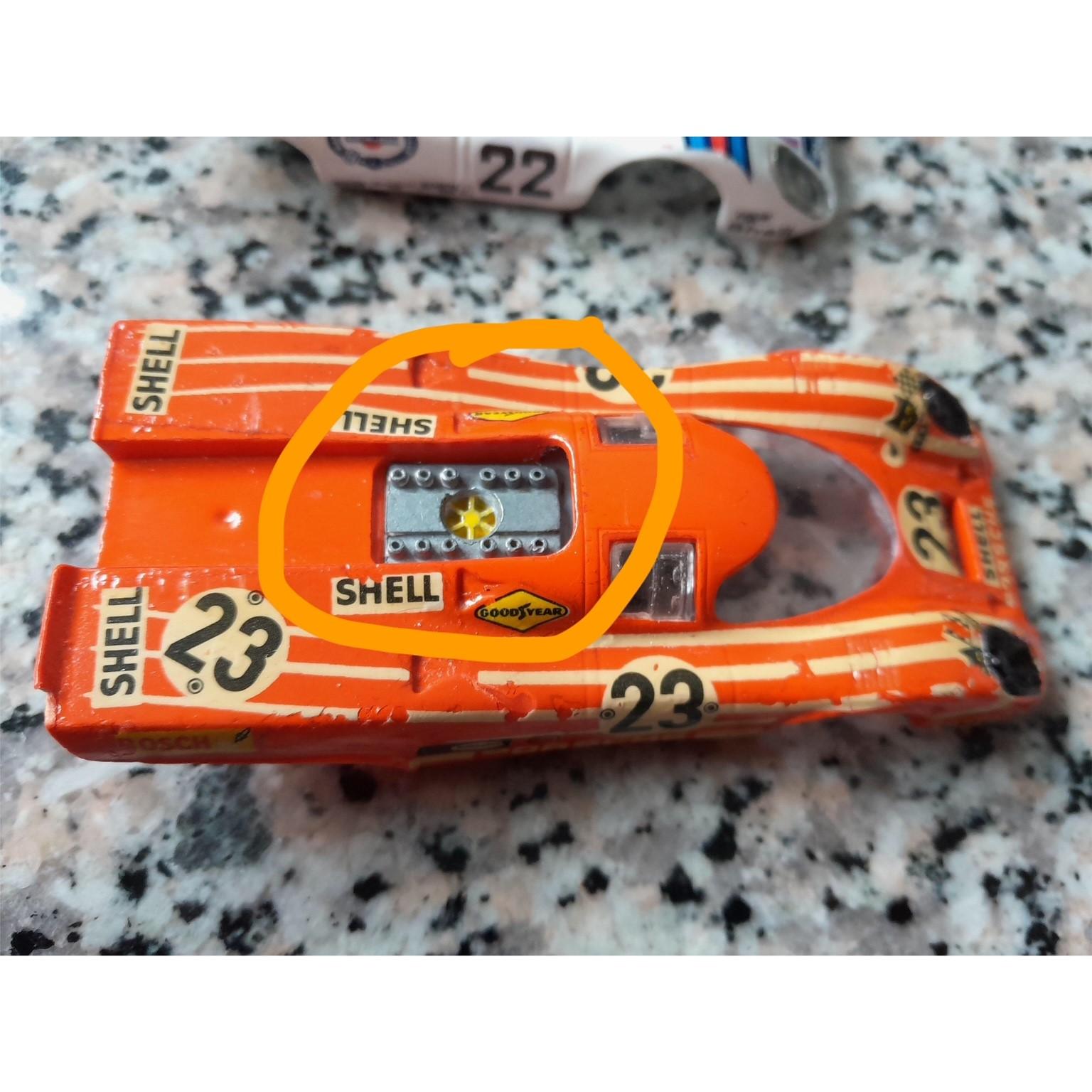

Good morning. I finished the body of the Rossi Porsche. Last problem was that Super Champion models don't have engine covers. As far as I know, Porsche 917s didn't have "open" engines. So I made a cardboard cover, painted it and added the correct decals. Now the chassis has to be procured and the correct wheel inlets have to be made.
Then I screwed the DS together. The rear rims are going to be really interesting. I had to cut off the screw flange so that the rims would even fit under the body.
  • Like
