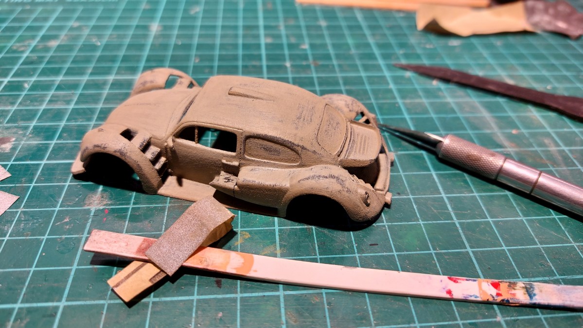

working on the Frankenbug ... sprayed with automotive filler and sanded. should be good for the first layer of paint now (finally!)
and trying to make foam tires out of a sandal, a great tip from Roland!
cutting the donuts with a drill bit made for ceramic tiles.
  • Like
Reactions: 3
Is that the body you were selling earlier and Tilo tried to make a mould of it or something?
Yes the filler primer can do miracles, I use that now all the times.
Looks like a lot of sanding to make those tires round, great tip though.
  • Like
Reactions: 1
