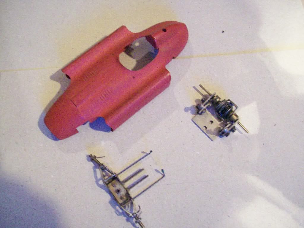

i thought I,d share these with you .I got them from e bay last week and i would think they were made in the late50s early 60s apparently by a gentleman called brian from peterborough who worked for perkins engineering
Brian are you out there?
Trouble is now i,ve got them what should I do with them. I am inclined to try and finish the model but dont really know what motor i should use or what sort of chassis to join the front to the back
This is the independant front suspension by equal length double wishbones ,the two bits of wire out of the back are actaully torsion bars which need to be anchored to the chassis .It also has working steering although the guide and track rod are not provided
This shows the bits ,the IFS and diferential came with most of a merit lancia ferrari
Now the piece de resistance a working differential that appears to be made from 3 sets of ELDI crown wheels and pinions and it really works .unfortunately the drive shafts are 2mm rather than 3/32 which will make the wheels difficult to fit
It also had some wheels which look like modified merit wheels
They are however fitted with rubber tyres hard as iron but the sidewalls decorated with the logo tri ang road speed?
any suggestions
cheers tony

In the mid/late sixties there were two clubs in Peterborough, an independent club in the city and the Perkins club. Eventually they combined but finally died out due to lack of premises in '71. I knew most of the guys that raced at both clubs and am still in touch with a few of them, but can't remember anyone called Brian, I'll make a few enquiries. If this was made in the late 50's/early 60's maybe this was done purely as a modelling exercise as, from what I know the first slot car club wasn't around till about '64/'65. However, looking at that front suspension, it does look as if there's a hole for a guide, maybe an MRRC type?
If you have any further info, let me know and I'll see what I can find out.

Hi Mike
The guy who sold me these said the guys name was brian from peterboro and he had some connection with perkins diesel
so i guess we have to assume that if he was associated with perkins he would probably have belonged to that club
I would think it could have been built any time before about 1965 as ELDI gears were still in plentiful supply then then
On the differential the driven gear is off to one side so I think the motor would need to lay assymetrivally in the chassis unless he proposed an inline angle winder with the motor lying diagonally accross the centreline
I think it could do with a sort of space frame to connect the two ends together and maybe a k.s of some sort to drive it .
any way if you do manage to track down the elusive brian it would be interesting to get some feedback from him
Cheers tony

I would be inclined to say go ahead and restore it, but it doesn't look all that easy... not sure how the motor is supposed to be mounted to the back for instance. Do you think it was ever finished at one time, and actually ran, or is just another unfinished project? If you need an old Pittman, be glad to help you there!

hi don
the fact that the drive shaft from the motor will need to be over to one side of the chasisstends to indicate that the motor will need to be offset or the motor will need to be assymetric
now i am sure i have seen pittmans that have that arrangement ,the ones that look like a padlock .It could be installed such that it lays in the chassis on its side with the output shaft over to the off side of the chassis to pick up with the driven crown wheel

Right Tony... now that I think of it, a lot of the 1/24 Strombecker/Merit conversions I've seen have offset motors to allow room for a driver in the cockpit.. The big Pittman laminated pole motors are by definition offet when you lay them on their sides, but probably too big for something like this.
PS: for instance, a Strombecker Scarab conversion:
