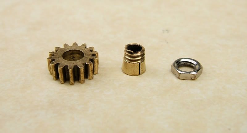

Thank you, gentlemen! The spur gear says COX 48T 4340 and the pinion is definately brass 14T w/ collet!! Really neat for you don't need a puller to move it, just a small 3/16" wrench! Will post a few more detailed picks for you..

Thanks Joel, always nice to see the pix.
I can't imagine Champion would do something like that if it didn't work... still, I never liked the collets, whether on K&B, MRRC or anywhere else. It wasn't so much staying on, but I always had trouble removed them even when the nut is loosened!
