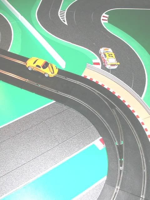

Progress report : still waiting for SSD (or maybe not ...
), I've now been driving the car around for quite a while. It felt really good, since it's the first time I have a complete track, rather than track halves - I'm having a bit of fun at last !
Grip is building up nicely as rubber is laid down, but it's already apparent that indeed cars will be substantially slower in a curve compared with traditional slots (excessive IMO)
Not unexpectedly, positioning the guide just aft of the front axle (actually, on the front axle for the Porsche, but there wheelbase is quite short to begin with) makes the car a real handful - also, the front moves inside during a slide, much nicer than the usual "hanging by the nose"
It does look a bit too much like rally driving though - like I said, I think I can also introduce understeer, but that will have to wait
A small problem I've found - but maybe it's just untrained me and the old plunger controller I use for now - is that my thumb gets pretty tired after a while of non-stop driving - de-slotting may be a drag, but at least it gives your finger a rest !

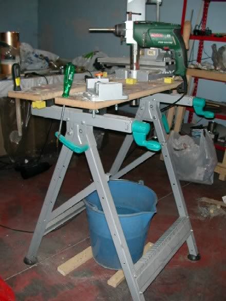

And now, for a bit of comic relief..... does anybody know what I'm about to do here ?
(hint : the bucket is to be full of water)
QUOTE And now, for a bit of comic relief..... does anybody know what I'm about to do here ? (hint : the bucket is to be full of water)
Relieve yourself?
...sorry... couldn't help myself....
Canadians are getting too cheeky as of late !!!
