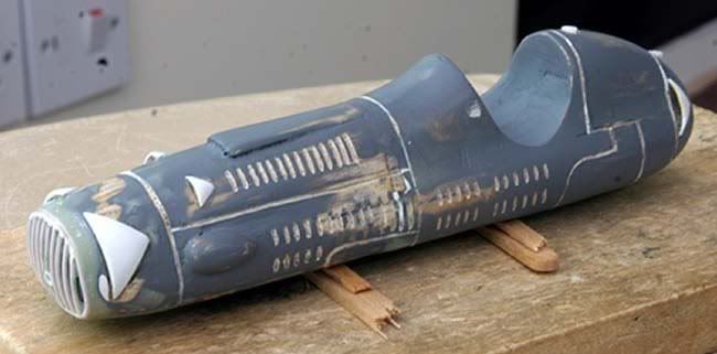

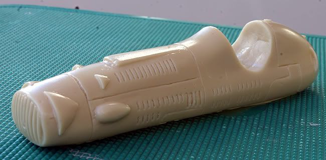

I decided to build the car for Mac Pinches Earlybird meeting at the Wolverhampton Club. I started with the drawings for the Maserati 4CLT in Model Cars magazine. I carved a balsa wood body which incorporated the differences between the standard Masser and Bira's modified OSCA bodywork which are the distinctive nose and various scoops on the nose, bonnet and rear cowling.
I then shelved the idea of racing the balsa shell and decided to mould it and pour a few resin shells from this and then set about the slot car build.

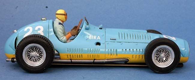

The resin shell was cleaned up, trimmed and the various vents and openings were drilled and filed out. All the small pieces such as rear suspension leaf springs and shrouds, mirrors, screen, dash panel, filler caps and exhausts were scratch built then the car was sprayed with Halfords acrlyics using Ford Olympic Blue and Fiat Broom Yellow. The car nose grille was Bare Metal Foiled.
Contemporary photographs of the car are very few and far between but I have several in my reference books and from these I opted for a generic version which is a bit of a mixture of these and the restored car as it is today. Likewise with Bira he raced the car in both leather cap and crash helmet and in various types of clothing, I opted for what appears to be a patterned polo type shirt and his distinctive yellow leather cap.
My driver figure was made from a mixture of Airfix multi-pose soldier figure pieces from the Japanese and US Marines kits. The Japanese head was used as it is similar to the Siam/Thai features and I added a leather helmet using Milliput and some fuse wire goggles with a drop of clear five minute epoxy in each lens to try and replicate the prescription goggles Bira wore.
The chassis uses the BWA front and rear slim line chassis pieces and an additional rear bracket cut down and used as the front engine motor mount. The other bits and pieces are a Scalextric FF motor, Slot it axles and gears, BWA wheels and inserts and Ortmann tyres at the rear and Scalextric Vanwall/Maserati rear tyres on the front.

O.K. David, now that I have finished hyperventilating (yes, I had seen some photos on the EB thread but these seem to have more impact) - couple of questions for those of us always trailing but also aspiring:
It appears that the radiator grille is pierced through, hollowed out behind and an additional bit of screen or pierced material set behind it. Is this the case or is it more of your "trompe d'oeil" painting?
How did you do the steering wheel?
Love the effect on the exhaust pipes - they really look like steel that has gotten very hot.

Beautiful, inspiring work David!!, the body is magnificent but its the little touches such as the work on the Areo screen and surround, open vents and that driver figure -wow!! The driver using the soldier figures facial features and the touch on the goggles really make this car. Thanks for sharing.

David. Having now removed my jaw from the floor, I can honestly say this is one of the most amazing scratchbuilds I've ever seen. Your attention to detail is astonishing. I am so looking forward to seeing this sat on the grid at Wolves!
I must also compliment you on the excellent photography - depth of field on those pictures is superb.

Al - the grille was opened up then foiled and I put some fine mesh behind it. I cheated with the steering wheel, it is from the Scalextric Vanwall. In fact it should be a four spoke but I didn't have one to hand.
Dave - The depth of field is down to Canon rather than my photography skills. I use a tripod and set the camera at F22, this gives a wide depth of field and a shutter speed of about 1 second in ambient light. I prefer natural light to flash as it gives better colour and tones I think.
