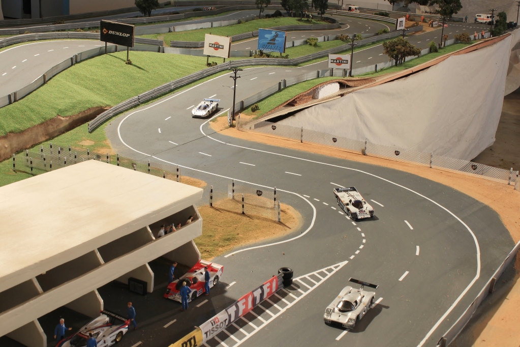

I used a 4\'x8\' wood sheet which I already had to do a simply circuit (I have routed on it a slot test track, so I am using the other side for the dnano). I painted the track with some outdoors black spray paint and used cork for the edges of the track.
Here is the track:
How does it run? The key point! I have just completed the track and after 10 minutes asked my daughter to film it. She said she would only filt two trials so here they are, the first slower and the second just a tad faster (I am a complete beginner). Further impressions on later posts.

Today was the first day I ran consistently without touching the borders at all (I have to say that it is a joy to put the dnano on the track and go for a spin).
#33 ·
I should update here my dnano project, a new track is being built, see below.
The dnanos have shown themselves to be fantastic and definitely work at scale dimensions. These are now not first impressions but reality. Some elements are essential in the design of the track. one of them is the use of white line and then a space before the borders. Without that one would be banging on the borders a lot which is a turn off.

I love your track, awesome! I think with the painted MDF it doesn't look synthetic like most tracks do in micro R/C world. What paint did you use anyway? Could you try the track with your HPI RS32? Have you driven it a lot?
