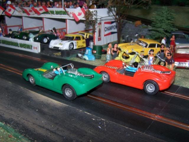

My second one (orange) came yesterday as well as Ortmans. The Orange one is used but other than missing mirror and roll bar rubbing it looks to be brand new.
I installed Ortmanns, trimmed guide and oiled them. I did some painting in cockpit areas. They go rather well. The green one is maybe a tenth or two of a second faster.

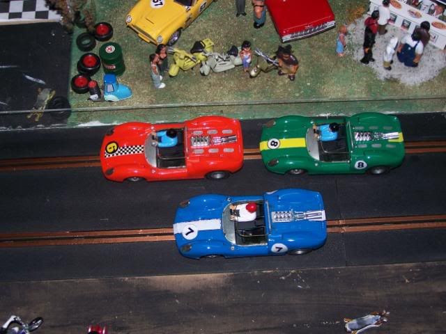

They multipy if left together. Mix green and orange and they begat a blue one. I got it mainly to try putting a Scaley motor in. It went in without any cutting of the chassis. I Super glued the Fleishman pinion. Hot glued the motor. Went so well the others got an upgrade as well. The blue one still has original tires so a little loose. I have added Tarn weight to all three. It made quite a difference. The orange and green ones are shod with grey Ortmans.
These are fun cars and look or so good. Their lap times at 6.8-9 somewhat below most non mag cars at around 6.0 -1 but who cares.
The blue one had a very scuffed up windscreen. A coat of Future/Klear did the trick. Scuffs disappear. I am not happy with my decals so will redo the blue one. I will also do the grilles on rear deck with a Sharpie AFTER I wax again.
In the third pic bottom right - road kill.
